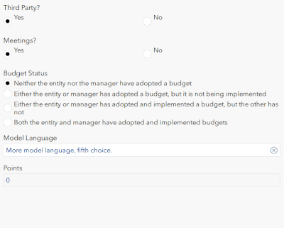

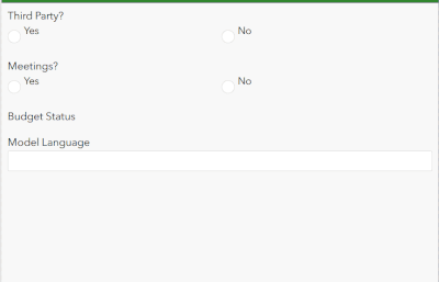

This one looks pretty straightforward. The constraints on Budget Status come from the preceding questions, but the model language looks like it is 1:1 with the total choices available in Budget Status, right?
In that case, you could have an external CSV with the 12 possible choices in Budget Status and bring it in with a pulldata. But since it's such a small list, you could also handle this with a hidden select_one.
Now, getting additional values into that model language would require some concatenation of other questions / calculations. But it's doable. Try to break it up into chunks whenever possible so as to avoid a gigantic IF expression, as those can be a little hard to keep organized.
Here's the workbook:
typenamelabelappearancecalculationchoice_filter
select_one yes_nothird_partyThird Party?horizontal
select_one yes_nomeetingsMeetings?horizontal
select_one budgetbudget_statusBudget Status  third_party = ${third_party} and meetings = ${meetings}
select_one language_codelanguage_codelang codehidden${budget_status}
textmodel_languageModel Language jr:choice-name(${budget_status}, '${language_code}')

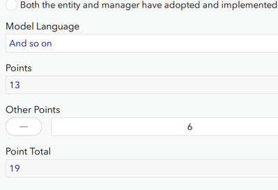

I like where this is going. The other part of the ask is that the user can amend the model language within the text box, as there are parts of the response that are unique to each community and cannot be fully automated. Is there a way to allow for that, or would that have to be captured in a separate text box?
jcarlson
MVP Esteemed Contributor
Yes! That text box in the animated GIF can be selected and edited after this initial calculation happens.
You could possibly have the model language input placeholder text like "Model language for community [XXXX]", then use a regular expression constraint to ensure that the placeholder are replaced by some other text.
You could also concatenate text from another box, but this would require a bit more work, and if the model text isn't consistently formatted, may be tricky. Supposing the model text all followed the format "string_part_1 + placeholder + string_part_2", then you could just repeat my above example with a separate hidden select_one for each part of the full string.
But in my opinion, that's getting too complicated. Just allow the users to edit the model text, and think about having that constraint to check that something's been entered.

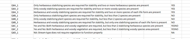

Thank you, Josh. One last question (hopefully)...
The current organization of the Choices sheet allows us to use different list_name values to assign points to their responses, which are used in a calculation at the bottom of the sheet:
Budget0Neither the owner or the contracted managing entity have adopted a budget. (0 Points)
Budget10Either the owner OR the contracted managing entity has adopted a budget, but it is not being implemented. (10 Points)
Budget13Either the owner OR the contracted managing entity has adopted and implements a budget, but the other has not. (13 Points)
Budget15The owner AND the contracted managing entity have each adopted a realistic budget and budget amendments are adopted as needed. Accurate monthly financial reports are prepared and submitted to the owner's governing body. (15 Points)
BudgetNo3p0The owner has not adopted a budget. (0 Points)
BudgetNo3p10The owner has adopted a budget, but it is not being implemented. (10 Points)
BudgetNo3p13The owner has adopted and implements a budget, but not all utility-related income and expenses are listed in a separate enterprise budget. (13 Points)
BudgetNo3p15The owner has adopted a realistic budget, with all related income and expenses listed in a separate enterprise budget. Budget amendments are adopted as needed, and accurate monthly financial reports are prepared and submitted to the governing body. (15 Points)
Bgt3rdPNoMtngs0Neither the owner or the contracted managing entity have adopted a budget. (0 Points)
Bgt3rdPNoMtngs10Either the owner OR the contracted managing entity has adopted a budget, but it is not being implemented. (10 Points)
BgtNo3rdPNoMtngs0The owner has not adopted a budget. (0 Points)
BgtNo3rdPNoMtngs10The owner has adopted a budget, but it is not being implemented. (10 Points)
Calculation (based on names from workbook):
(${Training_yes_no}-(-${Meeting_pts})-(-${Third_Party_Budget})-(-${No_Third_Party_Budget})-(-${Third_Party_Budget_NoMtngs})-(-${No_Third_Party_Budget_NoMtngs})-(-${Revenue_pts})-(-${Third_Party_WorkComp})-(-${No_Third_Party_WorkComp}))
Is there a clean way to implement your solution, using a single list name and filtering options, while still assigning point values to the responses?
jcarlson
I think you could repeat the language_code method and have a separate hidden question that associates each budget code with a point value. With an associated integer question, you can see the point values:
If you don't want to use up a field just for this, you can also use the "jr:choice-name" function inside of a calculation. Just don't forget to put it inside of number(...)! Otherwise you'll concatenate your point values and get 10 + 0 = 100!
${other_points} + number(jr:choice-name(${budget_status}, '${point_value}'))

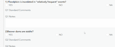

DougBrowning
You can have a calculation add text and then the user can edit.  When they do the little refresh icon will show, but if the user does not touch it then it will let them edit and keep the edits.
If you have a few messages a big if should do it.  If the text was not dynamic you could use pulldata for a cleaner look.  Now can you have field names in a pulldata that then fire - no idea you can try it.
I am guessing you want them to be able to add text but not edit the standard text?  Then it is easier.  Have one field for the a pulldata or if to get the standard statement.  Then a second field the user can type in whatever.  Then a 3rd field that concats these two together for the final text to submit.  I am doing this one on a project so that we can standardize a few comments.  I have checks for the standard and then a free form box that get combined.  I do not love it but could not change the schema so it works.  I even made it so depending on if they pick yes or no they get different standard comments.  I did this one using choice filter vs pulldata.  I just tried and the label will not take a field though.
Hope that helps more into may help
