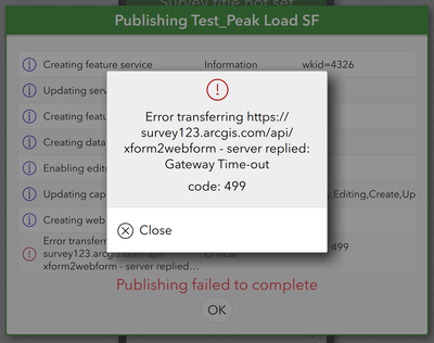

IanPierson
I have seen other posts with this issue and attempted to follow the advice given in them, but to no avail.  I made sure to update my Survey123 Connect version today (4/28/2021) to the most recent version. I have a huge file/survey. It works how I want it to within Connect but will not publish; I keep getting the 499 error code about a "Gateway Time-out". I have an external choices tab, as most of my surveys do due to the amount of information in them. I cannot figure out the work-around to this error. Apologies for the duplication of questioning when this is brought up enough as it is.
Thanks for your time.

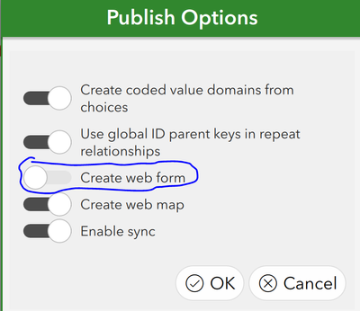

Hussam_AlJabri
The error wasn't produced once I disable "Create Web Form" from the Publish Option
CarynNezatUSDA
Our survey was also able to be published after turning of the create webform option.

Did you try to disable the creating web form from options? please share with us the snapshot of the error you faced.

I can't even get to the stage of publishing it as I need to update the form first with the saved changes in the excel spreadsheet but I get the error below when I tried to update it.
