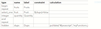

I am looking for this solution as well. I attempted to use JavaScript as described in
JavaScript funtions in Survey123 (https://community.esri.com/t5/arcgis-survey123-blog/extending-survey123-smart-forms-with-custom-js-f... but was unable to reproduce a working HasDups function in Survey123.  Has anyone else been able to successfully reproduce this example?  The constraint does not seem to register correctly. In the example below any fruits entered are an invalid selection with the constraint (${dups}=false).
I attached an example file and script:

EvanR
Did you download repeats.js and place it in an "extensions" directory within your survey directory? You have to do that before you can call the script from your XLSForm. I was able to get it to work in Survey123 Connect once I figured out that step, but it didn't work when deployed to field tablets because of some restrictions on what exact flavors of AGOL etc. allow JavaScript, which was a bummer.
See here and also here. Let me know if that doesn't work for you and I'll take a closer look.
AndrewPadilla
Thanks for your response @EvanR. Yes, I should have mentioned, I had placed 'myFunctions.js' in a scripts folder (I believe the extensions folder works the same). In the end I did get it to work. It was as simple as placing quotation marks around false in my constraint. I have attached a revised working example. JavaScript files cannot be added here. One would need to create a 'myFunctions.js' and use the following function and place it in a scripts folder with in the survey folder:
