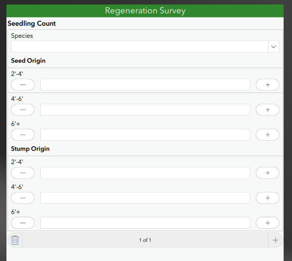

Hello - what I want may not be achievable using a repeated question but I'm trying to make a very dynamic survey with minimal question clutter. This survey will be used to monitor seedling regeneration following timber harvests. Page 1 of the survey covers plot information and then I currently have a repeated question on Page 2 (pictured below). The user then selects a species and tallies regen in the 6 size classes, adding a new entry for every species.
What I would then like is to run a few different summaries based on those entries. Total by species/size class, calculated trees per acre using our plot factor, and comparing values against a set index to assess regen success.
The problem I'm facing is when I reference the fields in the repeat, it is only registering the active repeated question and not all entries within the repeat, so my calculated fields are reading out 0 when there is actual data there.
Is there a way to achieve this within a repeated question or should I be considering a different survey design? There are ~30 species to choose from, so the repeated question would be a good way for me to only analyze present species without having to create a question for every species.

Summaries need to go outside of a repeat. Use sum() to add up items that exist in a repeat. (The calculate for sum() needs to exist outside the repeat).

Survey123 supports a handful of functions to work with repeats - max, min, count and sum.
You can join strings together but it's more useful for a visual summary of data collected, harder to work with for calculations. So easy repeat calculations are largely limited to math.
You could use string functions on summarized text e.g. Sum all species questions, then use contains(string, substring) as a relevant statement to hide/show questions specified to the species (substring).
More complicated analysis will likely require a JavaScript function. You can pass the repeat into JavaScript as an Array and then do a lot more than you can within the XLSForm.
