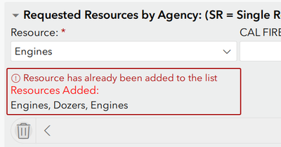

I have a select one list in a repeat where I want to stop, or warn, a user if they pick an item more than once during the repeats.  This list is about 1,300 items.
I created a field that keeps a running list from my repeat
join(", ", ${SpeciesList})
I tried this constraint on the list  not(contains(${AllPlants}, ${SpeciesList}))  but it always triggers since it is in the list as soon as i pick it.
Is there a way to count the number of string occurrences?  Or remove it from the check somehow.
Thanks for any ideas

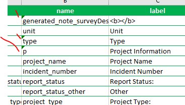

I highlighted the repeat section in the excel spreadsheet. Thanks for taking a look.
DougBrowning
MVP Esteemed Contributor
I see it works in Connect fine
Sorry I have no idea on the web.  I do not see anything but I never use the web forms so I really do not know.  Maybe someone else will.  Sorry
Oh wait I see you are using reserved words. These little green boxes mean not cool.   Could be it.
Also not sure you can start a field with a special char.  Prob not
_size
Hope that does it
