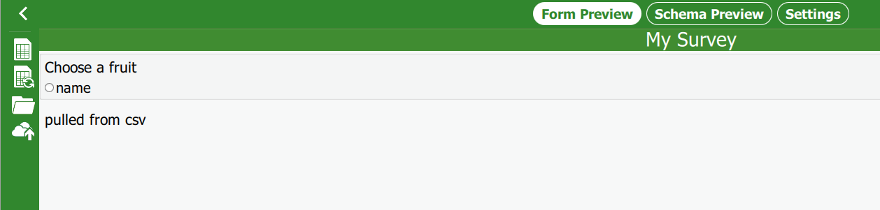

Once I load the survey I will be seeing the choices listed in the choice list and not the csv in the case my choice will be "name".

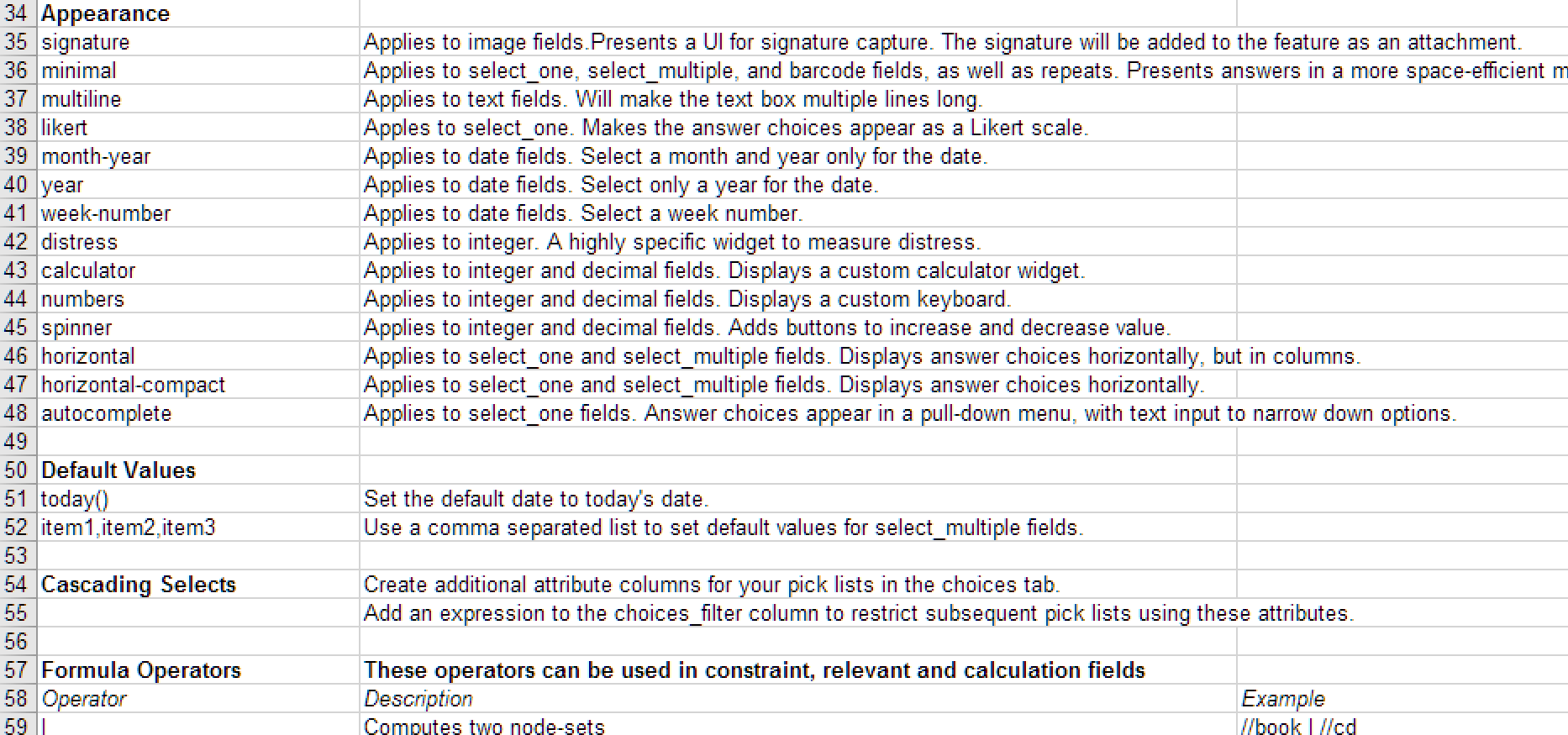

I think the problem is in the search() expression where it is not reaching out to the csv. I double checked for search in the types sheet under appearances and still I can't find it.

Hi Rami,
Currently we do not yet support the search() function- we've added it to the list of enhancements.
