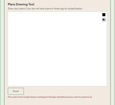

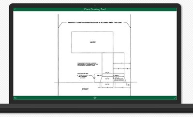

GusMacias
I created an image question for my survey in which I wanted to provide a diagram for the user to draw upon. This loads correctly in Connect but does not load correctly across the web app. It does however work in the Survey123 app. Posting on this thread because it may be a similar issue. I am receiving the error message in the web app:
File could not be found (leave unchanged if already submitted and you want to preserve it).
I would appreciate your help with this. See attachments below.

Hi @GusMacias,
Thanks for sharing your XLSForm and the default image. One thing to note is that the image you provided has a .jpg file type, but in the xlsx file you reference a .png file. Once I changed that I was able to get the default image displaying in Connect and field app as expected for both draw and annotate appearance.
As for the web app, this is a current known limitation, that default images for image questions with draw and annotate appearance do not display. This will be something that needs to be addressed in a future release, for now it will be documented as known limitation.
If this issue is important for you to be resolved, I encourage you to submit an issue via Esri Support. Our Support team will assign an official support number for your records. Similar requests from other customers can then be attached to the same issue, which helps us assess demand and prioritize it accordingly.
Regards,
Phil.
