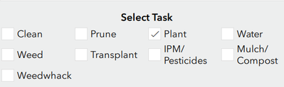

Is it possible to detect in real-time when a list item is selected, so the relevant list is displayed.
Thank you for any help you may give.
ClayDonaldsonSWCA
the selected() formula can be used in the relevant column to accomplish this.

JoseBarrios1
if the question is for a select multiples, you can use the selected function in combination : selected(${SelectTask}, 'Plant') or selected(${SelectTask}, 'Prune'). You can also use the regex()  regex(${SelectTask}, 'Prune') more info here: https://doc.arcgis.com/en/survey123/desktop/create-surveys/xlsformformulas.htm#ESRI_SECTION2_BED1A39...
JB
vocono1953
Thanks to both of you. It turned out that the enumeration value for "Plant" was needed to make this work.
So, it turned that ${list_task}=9 worked.
Thanks again.
JoseBarrios1
Glad it works...FYI. if the question is passing "9" as value that will be the value  for the record capture on the survey table. If you want the actual "Task" type to be capture, you have to change the name or  for the list or use another field to capture the label using calculate field.   jr:choice-name(${fieldname}, '${fieldname}')
