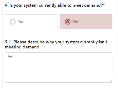

Hello all,
I built a secondary QA survey to allow an admin to review/update any of survey responses.
The survey has a few relevant questions and I cannot make it work the way I want. here is a situation.
Q9.1. is only visible when users select 'No' in the Q9.  In the first survey, a user answered 'No'  to Q9 and then put 'test' inQ9.1. and that's what I see in my secondary survey.
But in my secondary survey, I want to change Q9 to 'Yes'. (it won't be visible), and want any existing values in Q9.1. disappear. Since Q9.1. is not visible in this case, I cannot tell immediately if the existing value is deleted or not.
When I checked my feature layer after submission, Q9.1. still shows 'test' instead of empty cell.
Is there way that I can initialize the value to  null when the question does not meet the relevant criteria? I tested using both relevant and body::esri:visible but both do not seem working for what I was looking for.
