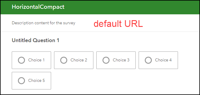

Hello,
We are using Survey 123 Connect to create a survey from a feature class. We're running into a minor aesthetic problem with one of our questions. We want the answer choices to be in the same row, so we went with 'horizontal-compact' for appearance. It seems like there isn't enough room on the page so one of the answer choices is forced to go into a new row below. Is there a way to change how wide the web form is in order to 'stretch' it and have that answer choice back in the same row as the others?

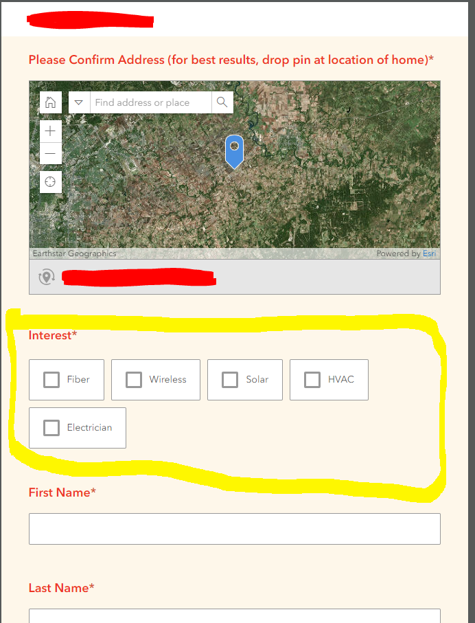

BethanyCrenshaw1
This is a great way to adjust the width of a form for use in the web app.  Is there a way to adjust the width of a form in the Survey123 field app?  I hope to fit as much on one screen as possible.
