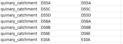

A selection of the entries in the choices tab:

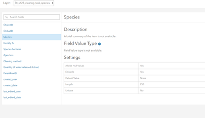

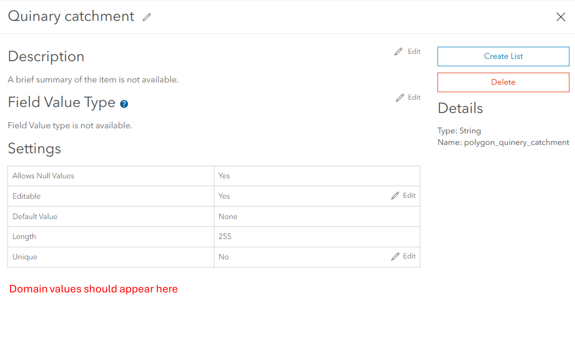

And the result in the feature layer fields:
Does anybody know why this is happening?

Thank you for sharing your XLSForm. Upon reviewing your form, I noticed that you have set the polygon_quinary_catchment field as a text question. This explains why the domain values are not displayed for that text question.
I attempted to replicate your issue by changing the text question into a select_one question as demonstrated in your screenshots, using ArcGIS Enterprise 11.3 and Survey123 Connect 3.21.62. However, I was still unable to reproduce the issue. The domain values appeared correctly, as shown in the screenshot below.

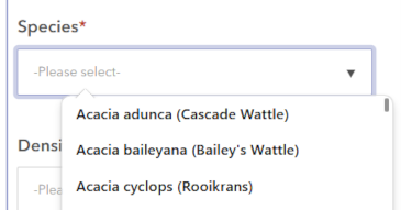

Would you mind checking on your side if the domain is created for the species field? Because in my implementation it is not despite select_one being specified and the drop-down list shown in the web form.
