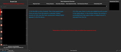

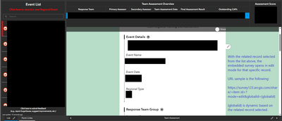

Regardless, I fully agree with you that it's tricky to have to maintain two apps which can get a bit confusing! One solution I have been using is to have team members launch the survey via a dashboard.
When they're editing records, they're always on desktop so what I've done is embedded the survey within the dashboard and have it so that it only triggers when a related record is selected from a list. Once that record is selected, the embedded survey opens with a custom URL that has editing parameters so that the existing record is updated.
Another option (probably more feasible for your use case) would be to have a URL dynamically generate when a related record is selected from a list that triggers Survey123 to open in edit mode for that specific record using the GUID parameter.
It still is two separate locations as opposed to one, but at least it's just a dashboard in a browser as opposed to a second app. Now the issues here are that you need to be online for this to work which may not be possible for your use case. With Field Maps, you can take maps offline which would resolve this, but again, would require a second app and corresponding training for field folks.
