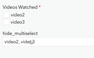

DarrylKlassen1
Thanks @abureaux , i have this working using this in my choice_filter:
selected(${hide_multiselect},label)
But this is achieving the opposite of what I want - is there a NOT selected option?  so the multi-choice shows the options that are not in my list?

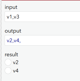

Excellent news! Okay, as I mentioned below, I realized after the fact that what I provided is technically the reverse of what you are looking for. But, now that you have it working like this, it is just a matter of "reversing" the process. Give this a try:
