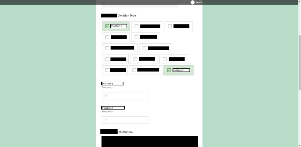

Hi everyone, I need a bit of help completing this last portion of my survey. Using Survey123 Connect Version 3.15.175 and Enterprise 11.
So I'm using a select multiple list to have certain textboxes appear when they select certain answers. The web app appears to do exactly what I want, only show certain boxes when certain answers are selected. But for the app, even when nothing is selected the boxes are still there.
I'm using the integer type and using selected(${column_viol_type}, "violation1") in the relevant column.
The select multiple is select_multiple violations, and the type has 13 different answers to select from.
Any help would be greatly appreciated.

jbrower
Sort of. When I edit the survey in Survey123 Connect, that empty space underneath has boxes where the boxes would come up if they were checked. Here is a picture example from Survey123 Connect and the Web viewapp view.jpgwebapp view.jpg
