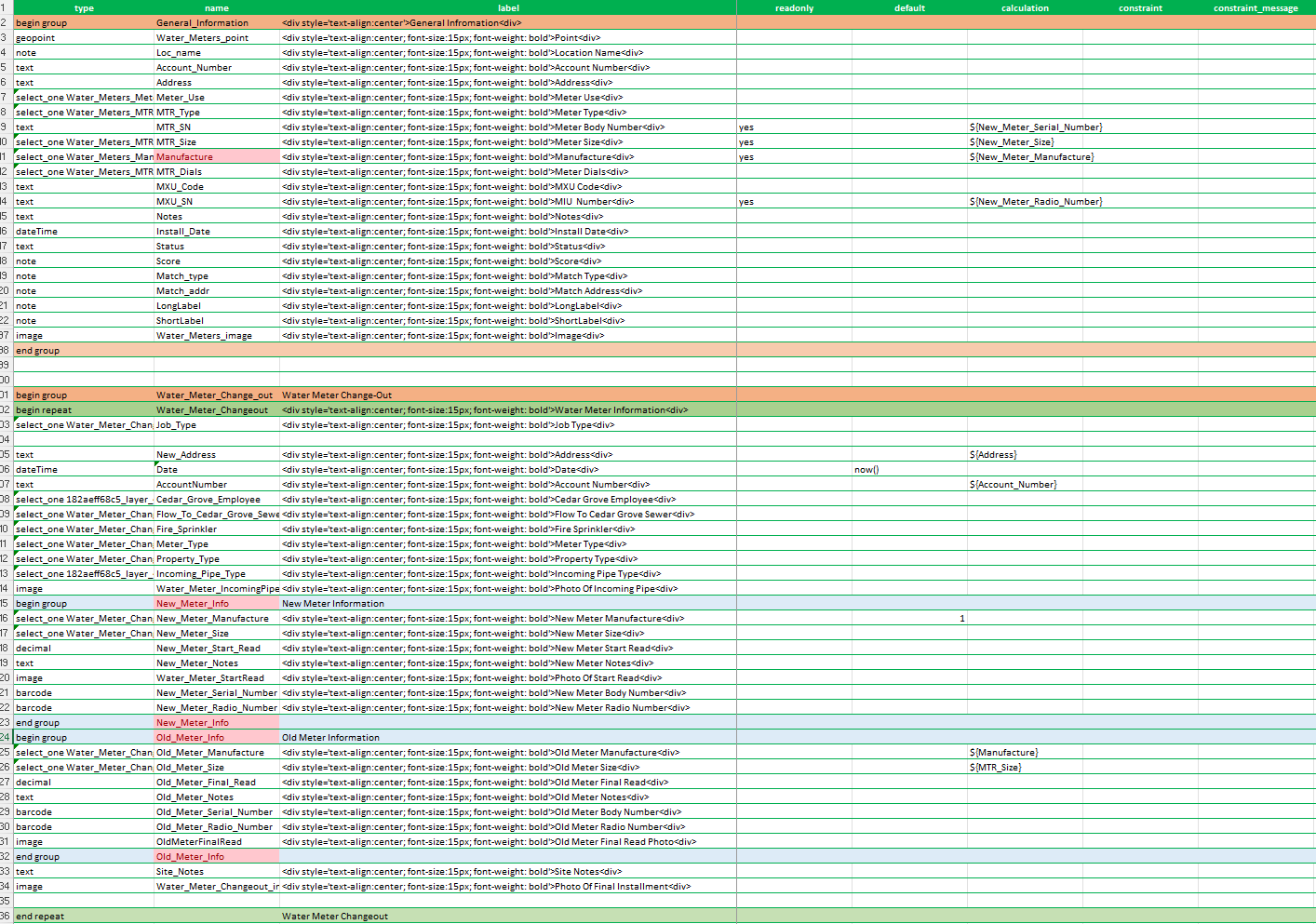

I'm trying to have my feature layer be updated as people fill out data in Survey123. In the survey, the first page is pulling the data for a water meter from the feature layer. The second page shows the related table where people fill out new information on the meter. My goal here is for someone to be able to open the survey see the current information on a meter (to ensure they are at the correct one) and be able to fill out information for a replacement on the meter which would be added to a related table so history on the address and its past meters is stored.
I was thinking of just having the feature layer fields be hidden and have them be calculated to the new information. That way as the related table is filled out its also filling out the feature layer. The problem with this is I am not able to see the current information before filling out new information.  Screenshot_20230221_014947.png
 If anyone has any suggestions, they would be greatly appreciated.
TaylorBlose7
Not sure if this is still an issue, but perhaps you could just build out a note field that shows the hidden values.
