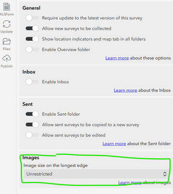

MichelleWilliamsERM
If you are using Connect, you can also do this, but the files could be huge in AGOL, so this is a delicate dance.
