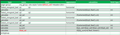

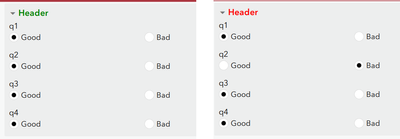

What I would do is set this up in stages: 1) Each question gets its own T/F logic, 2) SUM the individual questions, then 3) Use a logical test on that final SUM
In practical terms:
1) In this example, when someone answers "Bad" in one for the four questions, it results in a 1. Otherwise, the result is a 0.
2) Then, I SUM up all of my questions (four, in this case).
3) Finally, I perform a logical test. For my example here, I am assuming that if they answer "Bad" even once, then the color will be Red, otherwise it will be Green.

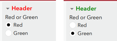

Also works with HEX colors.
Edit: In case it wasn't clear, you can use any logic you'd like/need. I just used a select_one as an example. The key is simply to replace the colored text (below) with a formula that will dynamically add the HEX/Color code:

Great! Thank you so much. If I were to have multiple questions under a heading based on the pass/fail would I do a separate calculate field for the heading and then reference the name of the calculate field?
abureaux
MVP Frequent Contributor
In practical terms:
