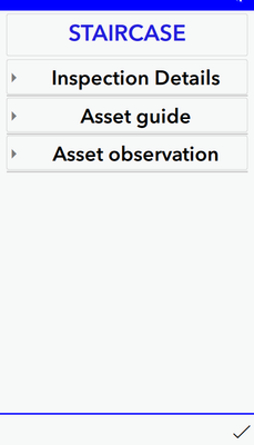

On occasion, you may want to display groups collapsed and let the end-user expand them if needed. This can be achieved by setting the appearance column to compact. It is not possible to dynamically expand or collapse a group with an XLSForm expression.

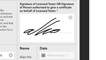

MGe
Hello,
could someone tell me how to embed the signature like it's shown in the example above, please? All i get is a button with a pencil on it which opens a pop-up for the signature.
(i want it like that)
Thank you very much in advance!
SarahLinn1
In your xlsx set the Type field to image and chose signature in the Appearance field.
MGe
@SarahLinn1 yeah i got this, but this only adds a field with a button with a pencil on it, but not the embedded signature field. 🙂
For example:
This is what i want:
This is what i got:
RobertAnderson3
MVP Regular Contributor
@MGe I'm thinking maybe it only displays the signature like that after one has been input and not just as an open input area on the form?
MGe
@RobertAnderson3 that could be absolutely possible! Thanks for your answer.
