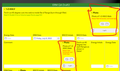

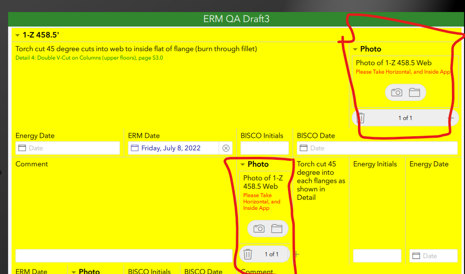

I want the image to have a width of 2, BUT it doesn't hold the width.MichelleWilliamsERM_0-1658506708911.png

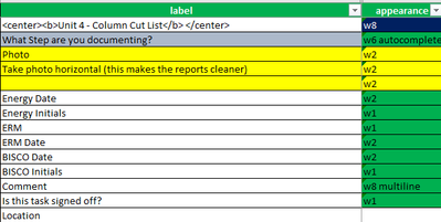

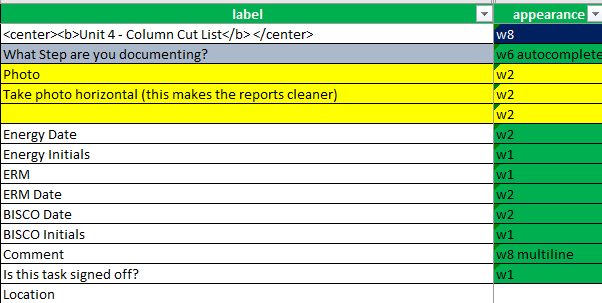

The work around is to have the overall at w8, the next line at w6, add the photo, and then add the next option at 2w (so it's forced to go to the next column, because it adds up more than 8).
Is anyone else having issues with other types not holding it's width?

Yes, I tried all the layouts, and the photo is the object that doesn't work, so I thing it's an issue with that item.
