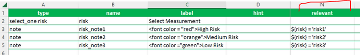

Ah ok. In this case, I would set up individual "note" type questions that will display conditionally based on the answer selected in the measurement question. You can use HTML formatting in the "Label" column of the XLS form. See example below:
Best,
Katie
If this post helped you, please consider giving a kudos and/or marking as the accepted solution. Thanks!
DrJumaKhudonazarov
As always  thank you so much  it works !

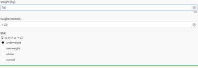

Hi Katherine. thanks. Very helpful advice. I am using connect. I will try  to use  the formula
DrJumaKhudonazarov
Hello  I think I am  doing something wrong  I used the formula and didn't  get the calculation . Can you please help?
Katie_Clark
MVP Regular Contributor
It looks like you entered the calculation under the "Hint" column in the XLS form. You need to have a separate field (row in the XLS form) that will return the value of the calculation (the BMI). For this row, you enter the calculation expression in the "Calculation" column of the XLS form.
Best,
Katie
DrJumaKhudonazarov
Thank you very much it worked! Really appreciate
