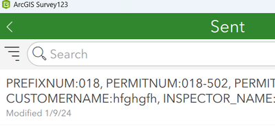

I have a form that has SENT enabled so the user can view and copy to new record.
My question is .. Can I format the text as seen in S123 Form .... see below...
Can I specify that fields I see here etc.

You can set this in the instance_name column on the Settings tab in Connect.
