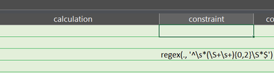

I may have misunderstood your question I apologize, the 255 limit will stay on the field itself, but the regex will prevent more than three words from being entered, if there are more, it will reject the entry like this:
I entered it here on the constraint column, but it would be for each question you would like to be limited word-wise.
