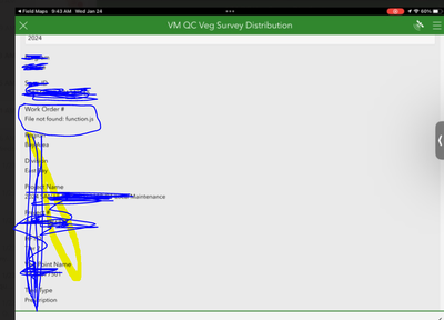

File not found : function.js - Getting this error after while testing the published Survey
1198
01-24-2024 10:23 AM
pramodmandali
I have created pulldata function to pass the parameter to my custom javascript function and it is working file when I test the changes in Survey 123 connect but while testing the survey, getting file not  found function.js error.
