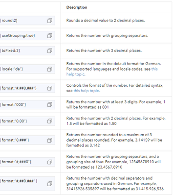

 For reference:
Note that the reference page custom to your survey can be found on the Survey123 item page for your survey > Data > Report > Manage Templates > Quick Reference
Hope that helps!
