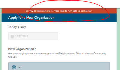

I ran into the same issue, where I couldn't preview survey123 hosted layer in Web Map Viewer. Unless I changed that setting 'What features can edits see?". However, once I try to open the hosted layer in the Web Map viewer my survey123 seems to be 'corrupted', I can no longer submit any surveys, and get an error below. I am trying to understand why is that happening and is there a way to fix it? Thank you.
