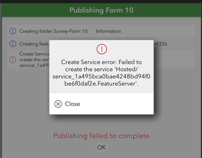

We are Publishing a New form (Survey123 Connect 3.13.251) in the ArcGIS Portal 10.8.1 and we encountered this Error:
This is often caused by using a reserved word as a field name or having some setting like field length in the wrong spot. Best thing to do is post the form.
I tried to publish the default field when you creating a new survey, just like this one:
i did not change anything here, i just publish it but i got an error
I would recommend enabling Logging. This may give you additional insight into what's going wrong.
To enable Logging: Click on your login icon in the top-right of Survey123 Connect > Settings > Diagnostics tab > Toggle on the "Logging is off" switch. Once you've done this, try publishing a survey again. If/when it fails, navigate to the folder that was listed as the Log Output Location and review the most recent log file.
Hmm do you have Publisher rights to create content on your portal?
Yes , I'm the admin of my ArcGIS Portal
I am having the same problem. Did you resolved the issue?
