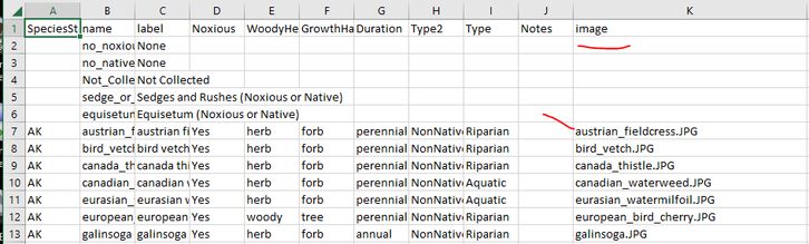

You can do it.  Just add a image column to the csv then the name of the image that it is in the media folder.
I think this is what you mean.

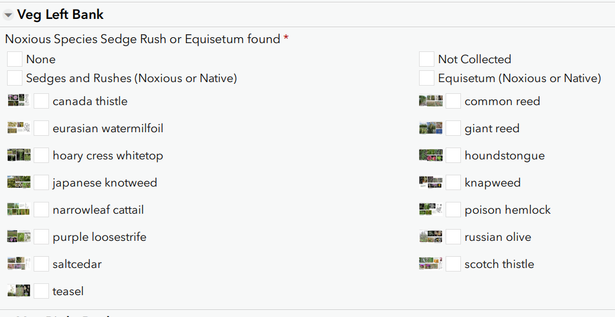

Just a standard select one.  The images will be next to the choice and you can tap them to make them bigger.  No special code it just uses the image column if it has it.
Works on select multiple also
Just try it, it is easy.
