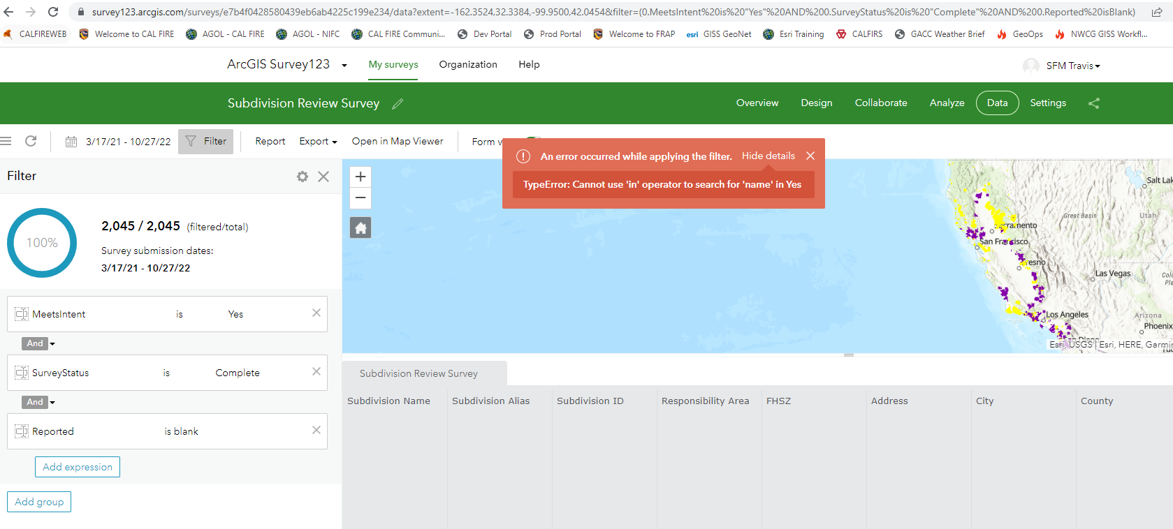

I am having trouble executing something that should, in theory, be possible.
I would like to use a URL (embedded in a app) to launch the data tab of a survey with a pre-defined filter and settings for the feature report. The current link just launches to the data tab:
https://survey123.arcgis.com/surveys/e7b4f0428580439eb6ab4225c199e234/data?
And when I manually construct the generic filter (not looking for a specific record, but records that meet broader criteria, like 'Approved = 'Yes'') the resulting URL reflects appropriated:
https://survey123.arcgis.com/surveys/e7b4f0428580439eb6ab4225c199e234/data?extent=-162.3524,32.3384,-99.9500,42.0454&filter=(0.MeetsIntent%20is%20%22Yes%22%20AND%200.SurveyStatus%20is%20%22Complete%22%20AND%200.Reported%20isBlank)
However, when I embed this as a link and use it to launch the survey the filter cannot be applied:
So what gives? It seems like it should be possible and I can't seem to reconfigure the bungled page at all in a way that makes it happy. I would like to provide our staff with a quick means to generate reports for all records that are 'on deck' and this would help us do that.

ZhifangWang
Hi @SFM_TravisBott ,
Sorry for the inconvenience. This is the same issue as https://community.esri.com/t5/arcgis-survey123-questions/filtering-integers-broken-after-october-25-... which was introduced in the October 2022 release.
We are working on a hotfix and will address this issue soon.
Thanks,
Zhifang
ZhifangWang
@SFM_TravisBott ,
The Survey123 Beta website https://survey123beta.arcgis.com has been updated with the fix to this issue. Can you please help test if the Beta website works for your workflow?
If everything looks good, we will deploy the fix to the production website on 10/31.
SFM_TravisBott
@ZhifangWang
The fix works as intended on the beta site. I'll look forward to the upcoming Halloween patch. Glad to see the self-inflicted wounds getting quick treatment!
ZhifangWang
The fix to this issue is available on the Survey123 website https://survey123.arcgis.com now.
Thank you again for the feedback and tests on the fix.
Best,
