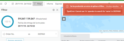

We are experiencing the same issue (see attached image). Worth noting that the filters I am trying to set do not involve numbers.
An error occurred while applying the filter.
TypeError: Cannot use 'in' operator to search for 'name' in [search term here]
