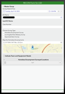

Hello,
I am creating a brand new form. I was able to publish it, but the updates did not reflect in the form. The error I receive is 'Error converting XLSForm'  I can't find the reason why this is happening. The last question type I added was a select one type. I checked field names and it is correct. I can't update or refresh the form at all.  I went into AGOL and made sure the select one question field name was added along with the domain. When I try to update the form in Survey123 Connect even with the new field added into AGOL, it will not work. I keep receiving the same error over and over. I sure hope someone can help. Thanks
