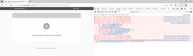

Good evening
When installing survey 123 web site version 3.11 I get the following error: "The survey does not exits or is not accessible".
It is installed on the same server Portal version 10.8.1, according to the solution indicated it refers to CORS. How can I solve the problem?
Thank you.

HaticeKorkulu2
Hello,
I have the same problem, too. Does anyone find a solution?
Thanks,
Hati
