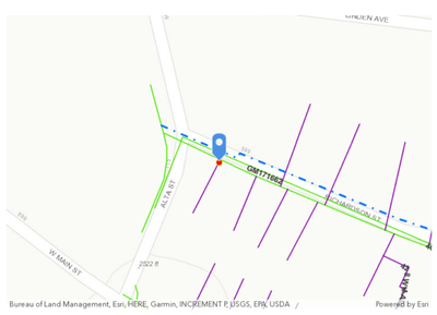

I read through the template and was able to use the following syntax to get my map to display on a test Feature Report:
${$shape|mapSettings:"39f34b30e1134b5bbb741c9b4ef8639f":1500| size:700:485}
There are no geopoint questions in this survey so I wanted to use the ${$shape} syntax. The map above is generally what I was trying to produce so now I'll just need to clean up the labels for a cleaner look.
