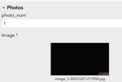

abureaux
MVP Frequent Contributor
All I did was add position(..) into the preexisting repeat alongside the image question. So, the structure hasn't changed.
