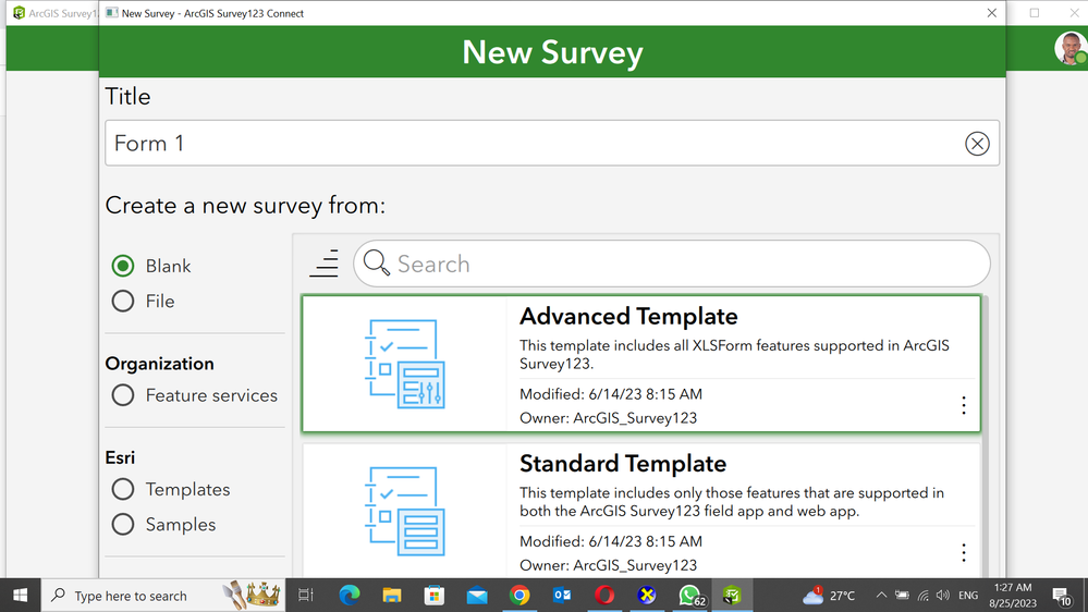

MohamedMomohKamara
Hi James,
As you can see from the attachment the window for creating a new survey does not appear based on my device screen size and I can't make a new survey because the confirmation button it's not seen. I tried to move or resize the window but I couldn't.
Can you please help me with the solution to this glitch.
