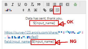

Greetings,
I tried to display dynamic URL in "Thank you" screen with Survey123 web version, not with Connect.
What I want to achive is to take users to another Survey123 form with input value as user's name.
It is possible to disaply input value as simple text in "Thank you" screen. But it doesn't work as expeceted with URL.
expected : https://survey123.arcgis.com/share/**********?field:input_name=id12345
obtained : https://survey123.arcgis.com/share/**********?field:input_name=%3Cspan%20class=
I know this could be done with Connect, but for some reasons, using web-designed form is constraint.
Any advice or information would be appreciated. Thank you.

Hi @JunFUKUDA
Thanks for reporting this issue - there is a known issue in the Survey123 web app with URLs that contain curly brackets { }. This issue has been observed in the survey form itself, as well as the thank you screen.
The Survey123 team is working on a resolution to this issue but no indicative timeframe at this stage. Please keep an eye out on the Survey123 blog and Early Adopter Community for release announcements. I would also encourage you to submit this issue to Esri Support so that it can be assigned a BUG number; this will allow you to track its progress.
Best, Jim
