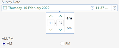

Hi all,
I'm having the following problem:
I would like to calculate a field for AM / PM based on the survey time.
I used the following code in the calculation column (where ${SurveyDate} = now()):
if(decimal-time(${SurveyDate})<0.5,"AM","PM")
This works perfectly fine for the mobile version
However, for the web version, it returns always PM regardless of the time.
Is this a UTC offset issue?
Does anyone have an idea how to solve this issue?
Thank you
IsmaelChivite
Esri Notable Contributor
if(format-date(${wsdatetime},'%h')<12,"AM","PM")   This expression will work if wsdatetime is a datetime question
IsmaelChivite
Badeschlapfen
aw... of course. Thanks, @IsmaelChivite !
