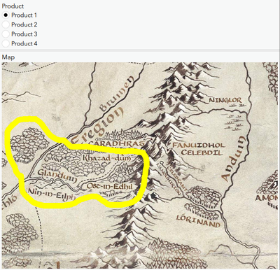

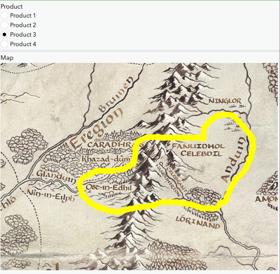

How many different maps do you have? It's simple enough to make an image visible based on a selected answer, but if you have large numbers of maps its going to slow down the survey loading.
