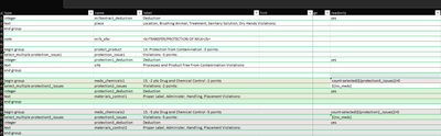

Is it possible to add a prior question with relevancy for those three groups.  This would solve the cyclic dependency.  See attached for example

@DeonLengton good call, I missed that in your explanation.  You still do need an 'or' but using it on the groups works.
I would still suggest considering the solution with relevancy I supplied above.  You could do a note question that explains the options prior to the type selection.  The benefit of this solution would be then you are not showing them non-relevant information and shortening the form.
