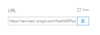

Go to the item page and find the service URL at the bottom right.

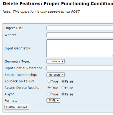

Then go to the page of the layer you want.  At the bottom you will see - pick delete features.
Then you can set a query or use the object ids
