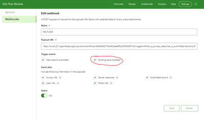

Yes, from the Survey123 website, select the survey, then select settings > webhooks, and check "Existing record edited" under Trigger Events:

Right. I should have mentioned that this is how you are supposed to enable the option on Esri's side. But Power Automate, at least in our couple environments (1.8.1 and now 10.9) did not respond once this option was checked. This is opposed to Integromat which did activate on edit (at least in 10.8.1), so I know it does work in some scenarios.
