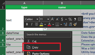

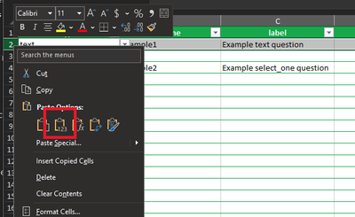

The next step I take when things are really acting strange is do a fresh copy:
  1. In Connect, start a new blank project
  2. Once the survey is generated, go into the old XLSX and copy the file contents
  3. Paste the file contents as text only into the new XLSX

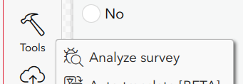

The end result is a clean document (e.g., no copy-paste shenanigans). To be extra safe, I'd also recommend running Analyze Survey to check for any anomalies (unlikely to help in this particular case though as I already did that).

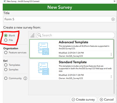

@abureaux @DougBrowning How did you both add the form I sent to your Survey123 Connect to test it?
I'm assuming you chose from File on the New Survey window!
I'm trying to eliminate possible issues.
Thanks

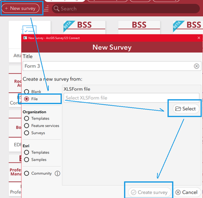

When you want to use an XLSX:
MPach
Yep, just checking that's what you did. I know the screen shot I sent was confusing because I had the Blank radio button selected. I was trying to see if I needed to try a blank form or not. Anyway, I did that too and still no luck. I'm going to let ESRI tell me what the problem is now because I'm at a loss.

DougBrowning
MVP Esteemed Contributor
Yes file option
