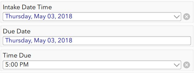

I have a form that opens with a select one question that defaults to no. The form also opens with a group that shows the intake date and a due date and a due time.
first showing

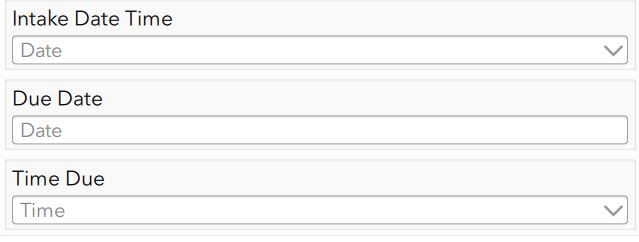

When I change the select one question to 'yes' this group disappears because relevant is set to only show the group when that select one question is no or null. When I look at the validate input screen all of the field values in that group are null as expected. When I change the select one question back to 'yes' this group is visible but now have empty values.
no date

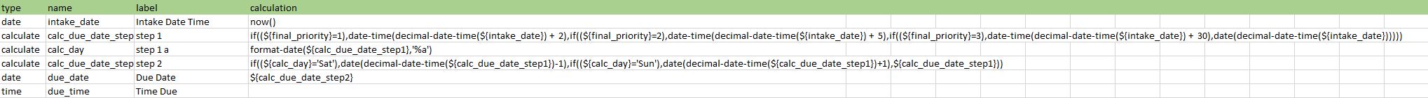

There are no relevant formulas on any of these calculations.
no date calc
The formulas contain code that evaluate the intake date and depending on a priority will set the future dates. If those future dates fall on a Saturday or Sunday it will advance one day backward or forward. Time has a default of 17:00
I tried adding the same relevant formula that I have on the group
${appointment_needed}='no' or ${appointment_needed}=''
but that did not make a difference.
