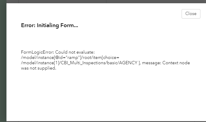

I published a survey that contains both external choices and pulldata tables. It works fine on my devices (iPhone, iPad Pro) but when I try to open it in a browser I get the below error and my external choices for "ramp" , "inspector", and "lastwater" do not load after selecting my AGENCY (first item in my cascading selects). I have the Survey123 app installed on my computer as well, and although it opens without an error, the choices do not load. I am attaching a zipped copy of the survey folder with all media files.

After taking a look at your XLSForm and running some tests, it appears that the issue is related to assigning a value to the bind::esri:fieldAlias column of the 'begin group' and 'end group' rows within the XLSForm of your survey.
Please try to remove these values, republish the survey, and attempt to load the web form again.

Thank you! I deleted those values and it works now.
