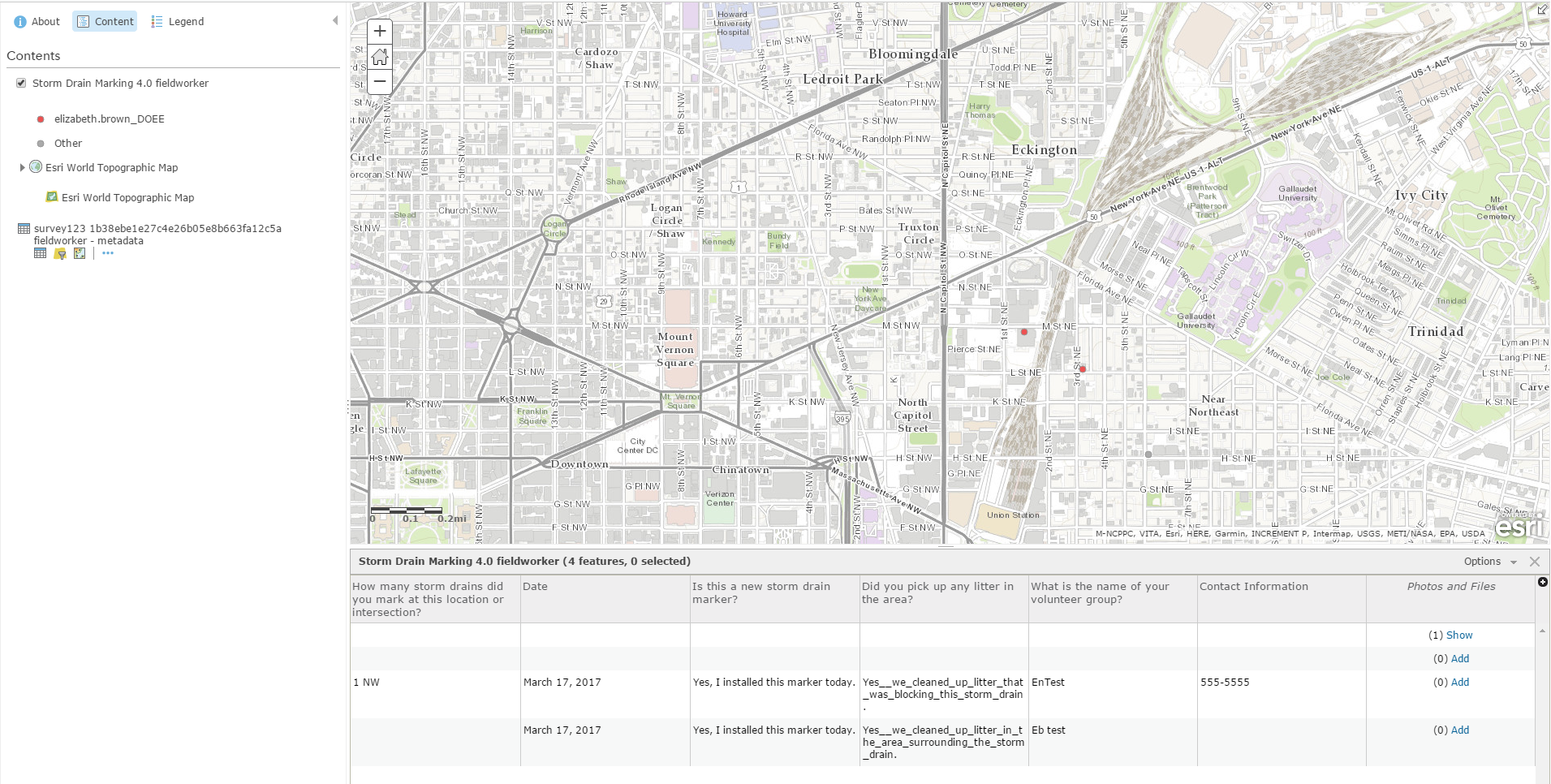

OK, thank you! I completed the steps described by you and the video, but I still can't see the data submitted by the "anonymous" user--only the data that I submitted through my ESRI account. I've attached a screenshot in case that helps. Any other ideas on how to fix this problem?
Thank you!
JamesTedrick
Esri Esteemed Contributor
Hi Elizabeth,
The steps to fix are to allow data to be submitted successfully from that point forward; it doesn't affect the already submitted data.
