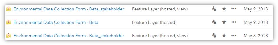

Thanks for your reply Ismael – I checked and have all of my permissions set to allow users to edit all features.  I can successfully submit and see my records (as publisher) but the users are still unable to see their data (nor does it show up in the Survey123 Data tab.
5/10 -
Thanks for the pointer Ismael - you were correct in that it seems as though one of the three hosted feature services did not correctly have ‘Settings’ tab for editing enabled; once I changed to match the other two, other users can successfully submit records to the HFS via Survey123:
The third stakeholder settings in the screenshot did not have editing enabled.  Once changed the records appear in the HFS.
Thanks again-
