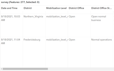

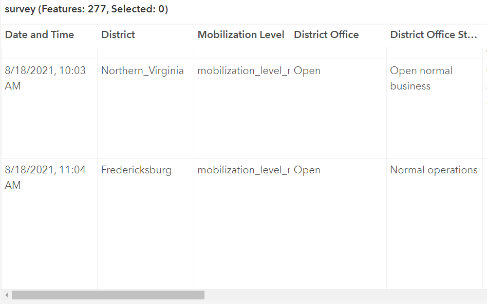

I am building a dashboard to display the survey information. I use a date selector in the dashboard to filter to the most recent survey completed. However, the dashboard is not picking up the data in the survey map layer. The first image below is a screenshot showing the data from the map layer. It shows the current date and time of the last survey completed.

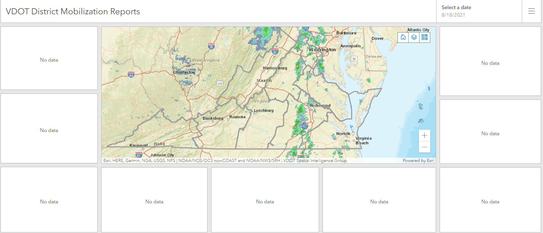

The second image is what the dashboard is displaying when I use the date selector to filter to the most current date survey.
I am using the new map viewer and the new dashboard. I didn't have this issue previously when using the classic version of both. Has anyone else run into this issue or have any idea why it wouldn't be filtering.

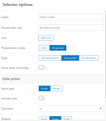

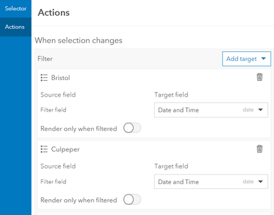

Here is the configuration for the date selector.
I have an action set for each list.

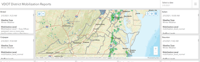

It does work on other dates as you can see in the image below.
 This is why I am so confused as to why it isn't picking up the current date

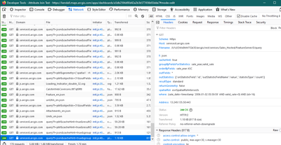

Open up your browser's developer tools and watch the network traffic. You should be able to see what query parameters it's sending to the server when you select a date.
- Josh Carlson
Kendall County GIS
Bryan_Wade
Unfortunately that is a little above my skill level. When I open the developer tools I'm not quite sure what I am looking at
jcarlson
MVP Alum
There should be a "Network" tab in there. When you click on your filter, you should see a GET request pop up:
You can see the individual parameters for the request, notably the where parameter. In the screenshot above, it's
where: (sale_date>timestamp '2006-01-02 05:59:59' AND valid_sale=0) AND (id=16)
I can see here all the statements in my filter, then cross reference with the data table to ensure that it's doing what I think it's doing.
