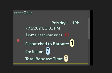

I have a dashboard that is used to track open cases and would like to configure a list element that will display how long each case has been open, among other things.
The closest solution I have seen is a calculation in the survey. The issue there is that the dates will not update as time passes, so surveys would need to be re-submitted daily to update the calculation. Is there a better way to achieve this?

Next question: Is it possible to have the calculated text appear only when a specific question is answered with a specific answer? In my case I do not want the calculated text to appear when the case is closed.
RickeyFight
MVP Regular Contributor
I believe you could just add an if statement.
// Check if specific question is answered with a specific answer
if ($feature['specific_question'] == 'specific_answer') {
// Display calculated text return 'Your calculated text goes here';
} else {
// If the condition is not met, return an empty string
return '';
