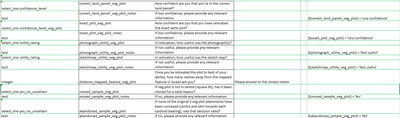

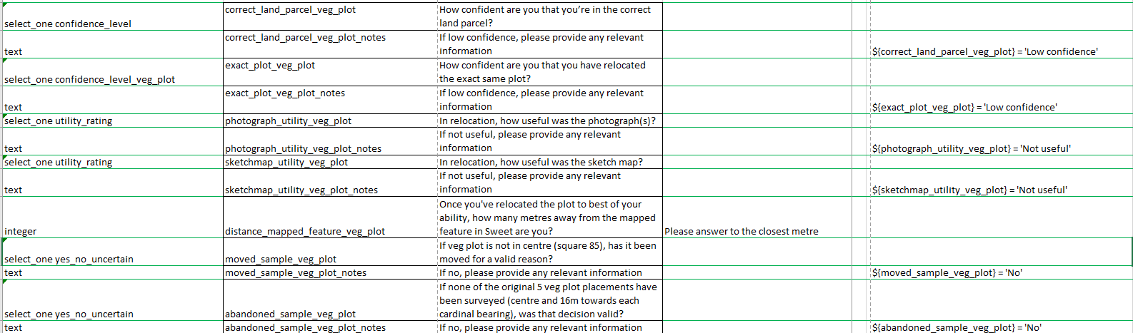

I am creating a 123 form using Survey123 Connect. I want to create some questions which only reveal themselves if a specific answer from the previous question is selected. I have followed the advice on the ESRI site, and have my form set up as below:

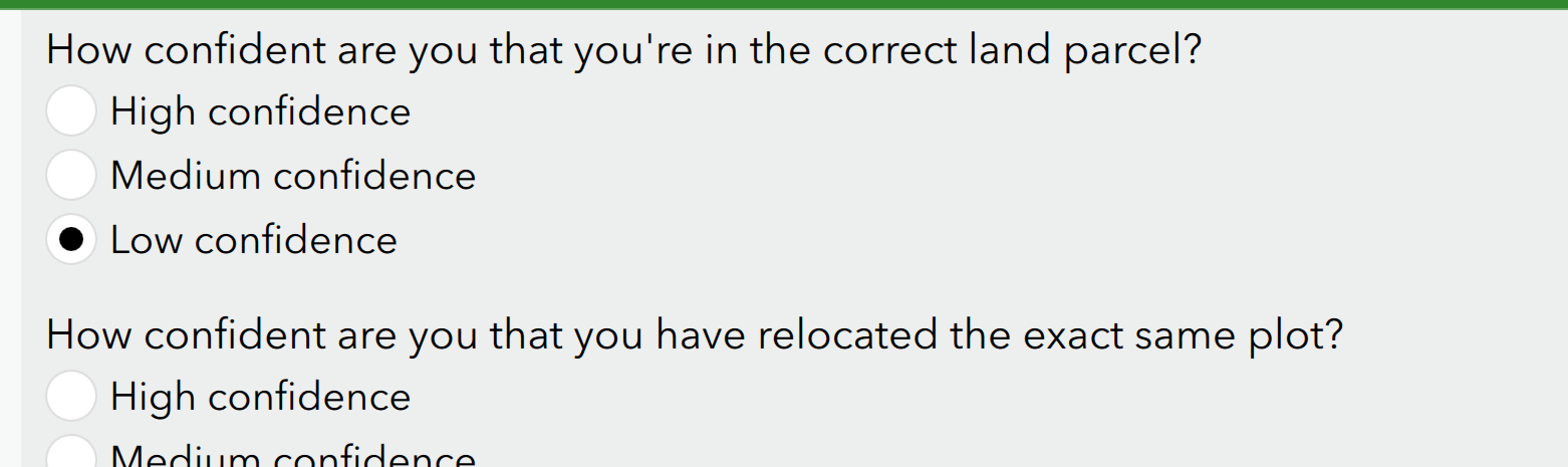

However, within the form itself, these questions do not appear when I select the appropriate answer:

Are you using the value to check from the label column or the name column on your choices sheet?  You must use the name value as that is what is stored in the data.  The label is just the friendly name for the user.
