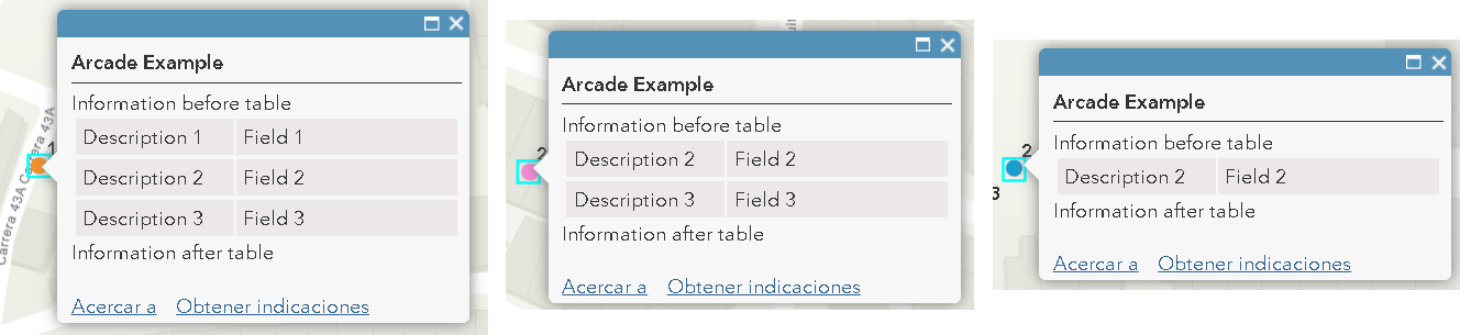

I have a feature layer, added 3 fields and randomly created some data including null values:
The idea is to create a table that will show the 3 rows when all 3 field have a value and hides each row that are empty:
So how can we hide rows and not leaving empty lines? This can be done by using a style that shows or not shows the row, which can be conditionally done using Arcade. See below the HTML used in the example above:

In this case there are 3 Arcade expressions. Each expression will validate if an attribute has a value or is empty. In case it is empty it will return "none" (hide the row) en in case it has a value it will return "block" (show the row). See below the expression to validate field 1 (the same is done for fields 2 and 3):
IIf(IsEmpty($feature.Field1), "none", "block");

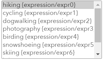

Hi @XanderBakker your tutorials on conditional images in pop-ups have really helped me!! I was wondering if it's possible to hide cells rather than rows if the field value is empty?
Here's my arcade expression that looks at an attribute to see if a specific value is there
var txt = Replace($feature["Activity2"], " ", "");
var lst = Split(txt, ",");
if (IndexOf(lst, "hiking") > -1) {
    return "block";
} else {
    return "none";
Here's the html code for the table where the images with links will be displayed, although unfortunately it doesn't seem to work. The conditional images show up, but it's not formatted as a single row table.

<HTML>
<header>
</header>
<body>
<table style="table-layout:fixed" width="1000px">
	<tr style="white-space: nowrap; overflow: hidden;">
		<td>
			<a href=""><img style="display:inline-block;" alt="hiking" src=""/></a>
			<a href=""><img style="display:none;" alt="cycling" src=""/></a>
			<a href=""><img style="display:inline-block;" alt="dog walking" src=""/></a>
			<a href=""><img style="display:inline-block;" alt="photography and filming" src=""/></a>
			<a href=""><img style="display:inline-block;" alt="birding" src=""/></a>
			<a href=""><img style="display:none;" alt="kicksledding" src=""/></a>
			<a href=""><img style="display:none;" alt="fat tire biking" src=""/></a>
			<a href=""><img style="display:none;" alt="snoeshoeing" src=""/></a>
			<a href=""><img style="display:inline-block;" alt="cross-county skiing" src=""/></a>
		</td>
	</tr>
</table>
</body>
</HTML>

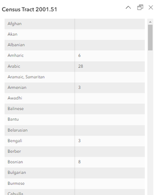

KateRose
Hello!
I'm working in the new Map Viewer, and have a layer with 49 features and 24 fields. None of the features have all of the possible attributes/fields populated, so like everyone else, I'm trying to configure the popup to only display rows where the field is populated. I have practically zero experience using custom expressions, but I *think* I understand the Arcade expression given by @XanderBakker above:
IIf(IsEmpty($feature.Field1), "none", "block");‍‍
So I would have to repeat this expression 24 times, once for each field, correct? And each would be saved as {expression/expr0}, {expression/expr1}, ... etc.? Do I add those in the Properties pane under PopUps/Options/Manage Expressions/Add Expressions or under PopUps/Options/Arcade (custom)/edit expression?
And then "block" refers to the HTML code (which would also need to be repeated 24 times)? I don't understand where to build/store that.
Will Xander's HTML codeblock above return the default table view, but only rows with populated fields?
Thanks so much for any advice here, I'm looking forward to learning how to do this!
