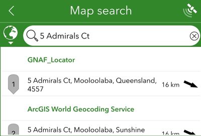

Oddly enough, I do get matches with a 'Map' type question using the same text with the custom locator.
Match in Map type question (GNAF)Match in Map type question (GNAF)
